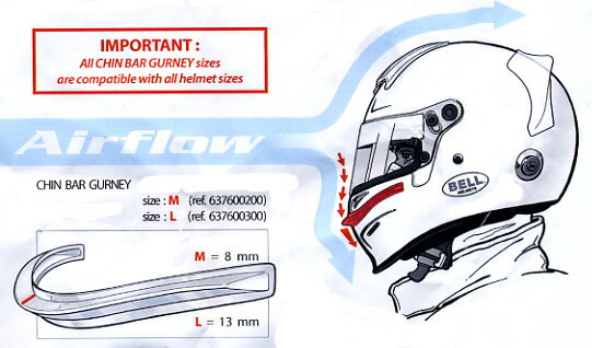

On the helmets, don't they have lots of transparent bits of plastic stuck all over them these days to move the air flow? I seem to recall the last time we saw a close up of Alonso on Brundle's grid walk there was a large perspex piece across the chin.
Not that I want to answer my own question but I just found this trying to find pictures of F1 helmets:
