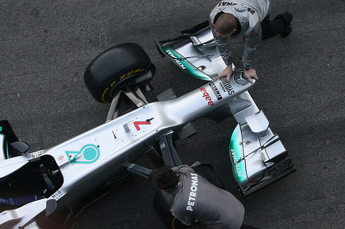

The Merc nose is noticeably more conical than some of the others we've seen. It's almost aesthetically acceptable! The front wing pylons are also rather large. Notice the opening is still in the nose too. Perhaps the passively blown front wing is a feature of their car after all. In fact don't they look like openings (mini intakes) on the lower edge of the wing too? Pure speculation on my part, of course.
