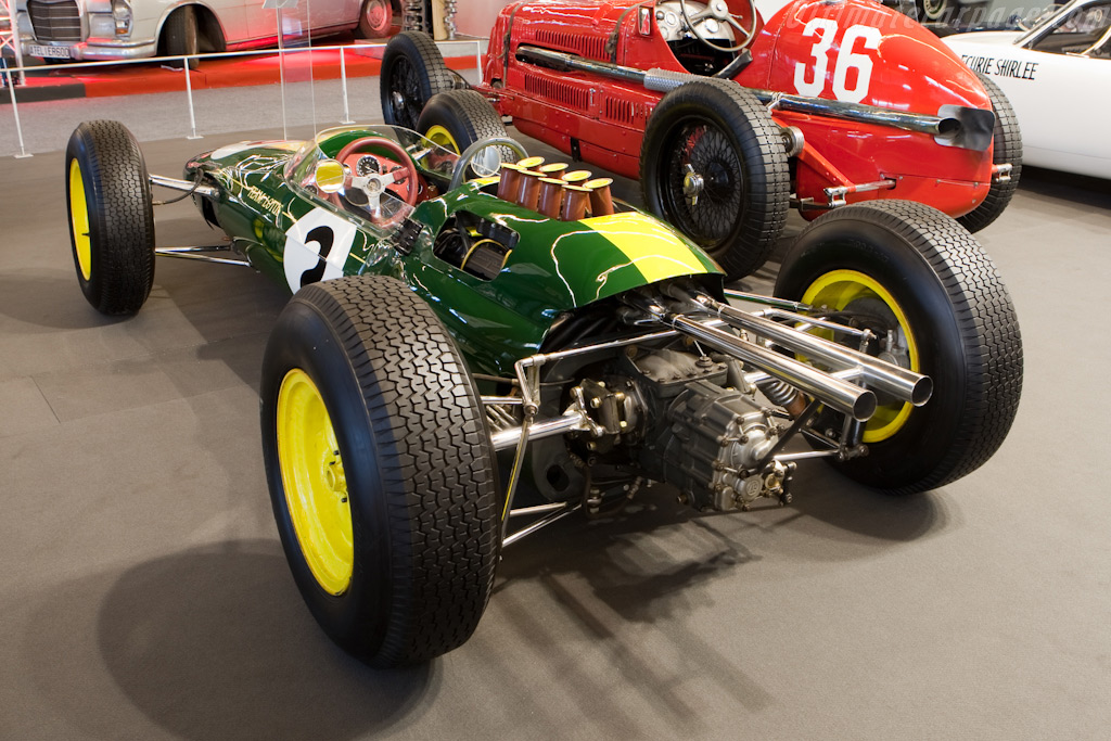

I still think they should have stipulated that the exhausts must terminate beyond the rear axle, something like this:
That would stop the buggers!
Yes, problem solved. But would it be acceptable on safety grounds to have the back of the exhausts protuding behind the rear wing? And if they don't then rear wing blowing would take over....
