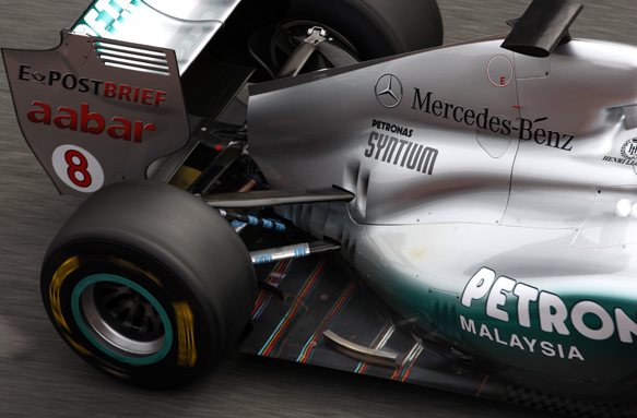

What does "coke-bottle" mean?
The so-called "coke-bottle" is the rear area of bodywork in front of the rear wheels. The idea is that it curves elegantly in and out, like a coke bottle does, exposing the upper surface of the floor.
It's important to get this area right as it interacts with the lower part of the rear wing, the diffuser and aims to minimise the aero blockage of the rear tyre.
