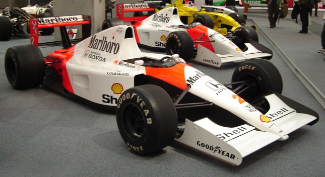

Now here's a low nose, and in a car that the driver can see out of properly too:
