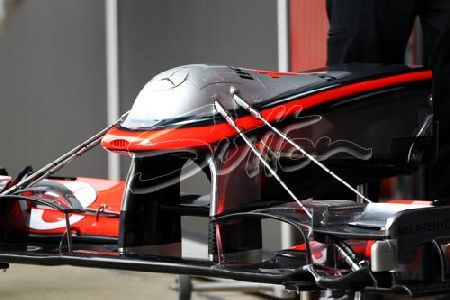

The McLaren front wing is flexing, not much but it is definitely flexing.
They were testing their front wing flex during both Barcelona winter tests as evidenced by a rather bulbous nose and cables attached to the front wing endplates.
Given the teams run ride height detectors during testing it makes you wonder why the FIA can't or won't make the teams use them on the cars during races.
