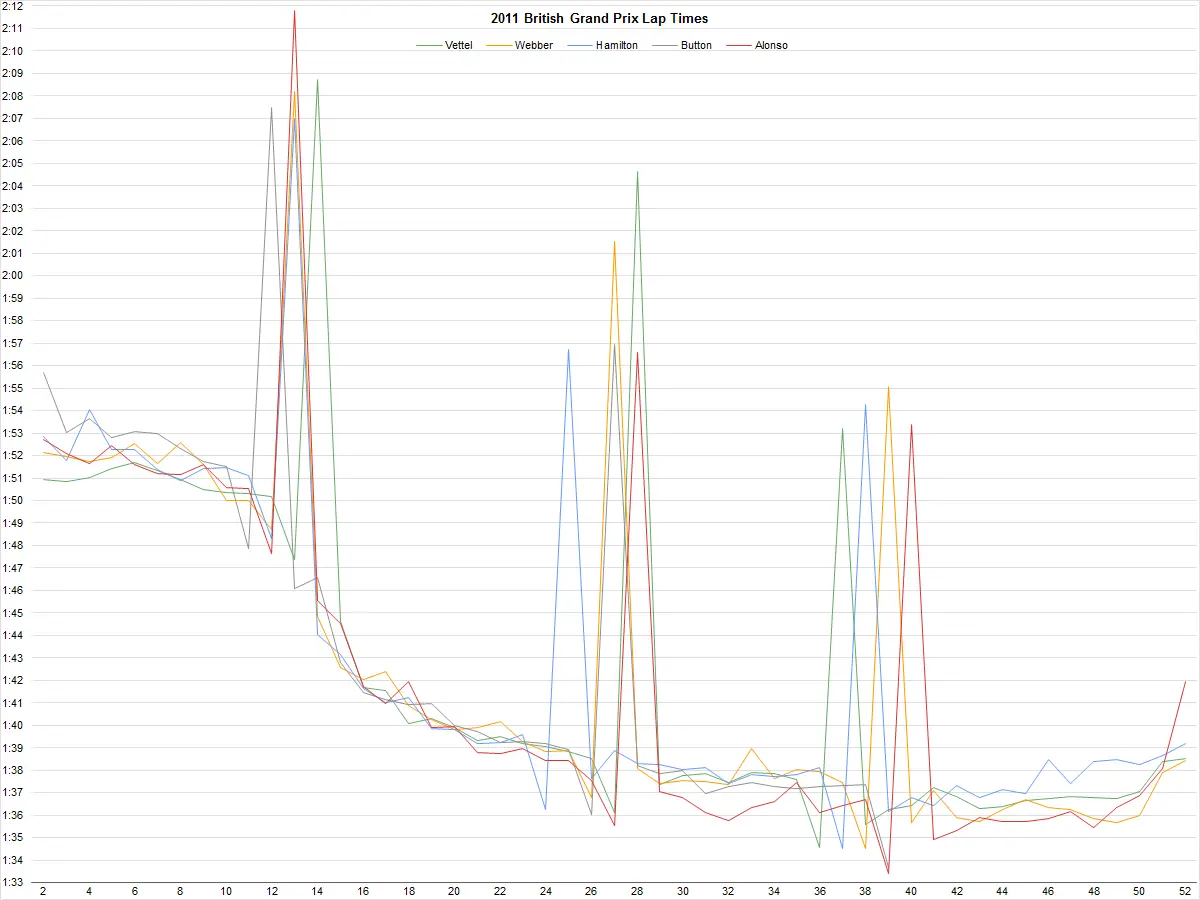

Did Webber lose a race win on lap 27?
Maybe another conspiracy theory.
On lap 25 Vettel led from Webber with Alonso a close third.
At the end of lap 26 Mark pits, seems like a normal stop and
he rejoins 4th as Alonso & Hamilton go past.
For some reason he has a slow out lap, it takes 2m 01.5s,
which is about 5s slower than most out laps.
At the end of that lap both Vettel & Alonso pit, Vettel
has his problem and Alonso passes him to take the lead.
Hamilton also passes Vettel. Webber is still 4th, but if
he hadn't taken an extra 5s on lap 27, he really ought to
have gained the lead.
One possibility is the collision between di Resta and Buemi
and the ensuing tyre failure on Buemi's Toro Rosso.
Anybody know any more?
I posted the lap chart on the other thread, but here it is.
2011-british-gp-lap-times-top-5-png.1983
I was going to comment on Webber's time when I posted it but forgot...
Was he held up by traffic or something else?
I thought I read something from Horner about them both having problems in the pits?
I don't remember any particular problems for Mark though.
Yes, but it was his out lap that was really slow.
In fact, his in lap remained his quickest for some
time after his stop. It was a long time before he
got into the 1m 36s.
