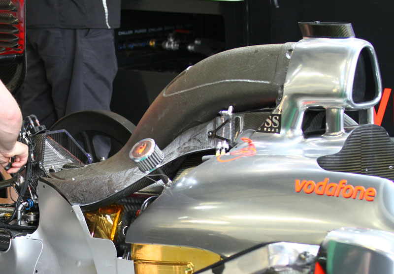

From what I've seen of Scarbs's photos and diagrams, at least the McLaren has its KERS cooling mounted higher...

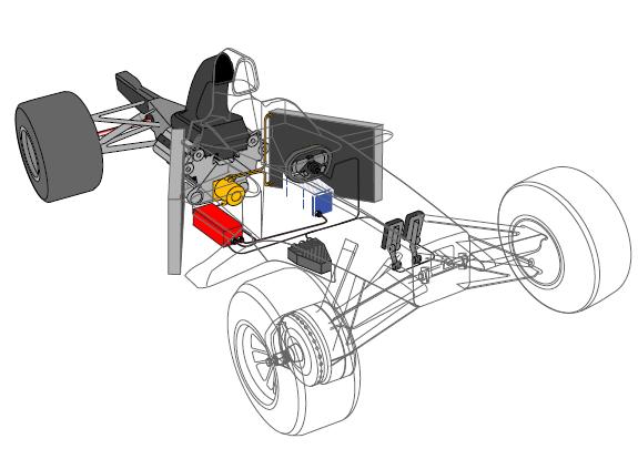

and no matter where you locate your KERS mechanicals they still won't be as low as a lead plate bolted to the floor. Certainly some components intrude into the fuel cell space (which is, after all, fairly flexible in its location), as seen in this generic diagram...
I'm not saying that the effects would be huge, but any car running with 40kg of bulky weight in compromised locations compared to 40kg of dense, heavy floor is going to be slower through the corners.
