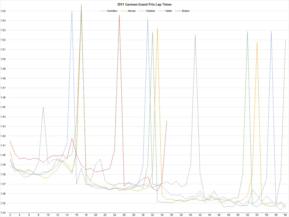

A little late, but here's the tyre analysis from the race.
It's interesting how many drivers set fastest lap on the prime tyre.
Obviously the slower speed of the tyre is being countered by the reduction in fuel as the race draws to an end.
One of the things that didn't seem to be mentioned was that yes, the prime tyre is 2 seconds slower than new softs, but its not 2 seconds slower than worn softs!
Yes that's a big factor.
Also, wouldn't track evolution help a little bit given that rain overnight basically made the circuit 'green' and as the race went on grip increased?
Also...Did track temperature during the race rise too? Perhaps it was cooler at the start of the race and slightly warmer an hour and change later?
It's going to be a combination of all of those factors.
Makes you wonder if any of the front runners could have pitted slightly earlier than they did.
I'll see if I can find the lap time chart I created.
Edit: Found it.
2011-german-gp-lap-times-png.2109
Yes, especially once the track had rubbered in as the race progressed.
I think MB did sort of mention it but not till quite late on, once Petrov started setting faster lap times on his new primes than he had on his last set of worn options. But you'd think they might have foreseen something like that a bit sooner.
Btw, that's a great chart, thanks Brogan. :thumbsup:
Those two charts illustrate quite nicely how Hamilton was able to keep his lead over Alonso at the end. Most drivers took 3 or 4 laps to set PB's after changing to the primes but Hamilton, looking at the lap times chart, was on the pace almost immediately, denying Fernando the chance of getting past by staying out longer on his options.
