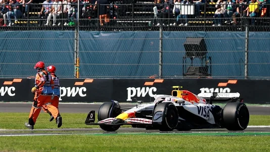

No one has mentioned the marshals who ran across the track in front of Liam Lawson during the race. Shades of Tom Pryce at Kyalami all those years ago. It was very close as they ran back across.
