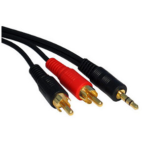

Reading the manual ( I know its got that bad ) I have a set of 'Pre Outs' unused on the back of the amp which the manual says can then be taken to a separate amp which is efectivly what the chair is. So maybe a simple adaptor for combining a phono audio red white cable to headphone jack would work if plugged in to this 'pre out' conection on the back of the amp. :thinking:
I reckon you need one of these Greenlantern101
http://www.ebay.com/itm/6-inch-3-5m...=US_Audio_Cables_Adapters&hash=item484efaef64
I stand corrected, although I have never seen an amp with male outputs or inputs before. Are you sure you are not going female to male to female to male to male to female? If that's the case, you could probably chop out whatever is in the middle and just go male to male. Anyway, hope you get it sorted.
