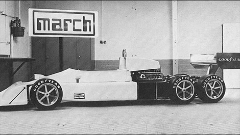

Colin Chapman also dabbled with the concept but he never got much further than this prototype:
Not exactly "Simplificate, then add lightness," is it?
