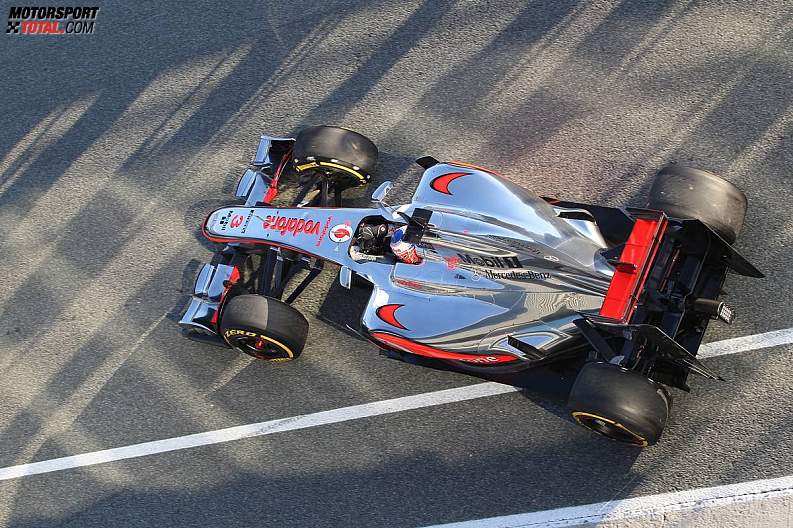

Has anyone seen where the McLaren exhaust exits are in the test? Apparently the 'plastic car' they unveiled might have been misleading on where they are actually placed. McLaren say thay have various options available so do we have any photos of this so far?

I was just going to post that image.
From others I've seen it appears McLaren are blowing the brake ducts but suffering from burning the rear floor of the car too. To be expected at a first test and easily resolvable apparently.
The purpose of the bulges remains unclear. It's possible they do not adhere to regulations but are being used as a device to adjust the direction of the exhaust gas flow but without having to actually change exhaust setup.

Indeed. As it goes McLaren have come up with a very clever exhaust solution this year, which I understand is being deemed legal - for now, at least by Charlie Whiting.
It basically uses the the air over the sidepod to force the exahust gases down and onto the rear brake ducts/ diffuser area.
Now since there is no aearodynamic effect directly resultant from the position of the exhaust and and design-wise it conforms to the regulations they're legal and free to carry on with them right?
Since in a static test there will be no aerodynamic gain from the solution McLaren have implemented? A static test just like the Redbull flexi wing passed time and time again even though it couldn't have been more obvious it was giving them quite an advantage? The Redbull was allowed to race. Sadly, my prediction is that the FIA will find some kind of reason to ban the McLaren solution even though it 'passes the test'. That or they'll just change the rules to make it illegal.
